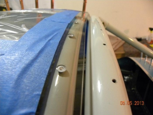

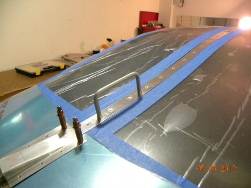

I decided to go ahead and rivet the forward bow of the slider as well as the center strip of the canopy, to the frame. These use real soft aluminum blind rivets (AACQ4-4's)

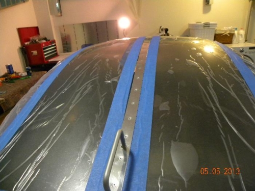

I also installed the aluminum handle at the rear of the slider that I crafted up. This will deffinately need some sealant in the future at these penetrations.
Riveted Forward Bow to Canopy
Riveted Center Strip
Slider Handle
Slider Handle
