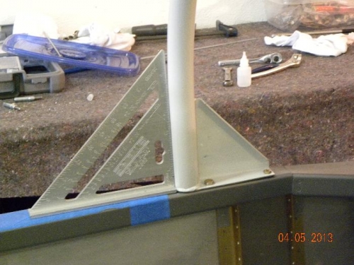

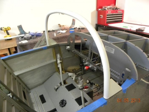

Luckily my roll bar frame matched the correct width of the fuselage with no bending at all. I the fasteners were pretty difficult to reach up under the fuselage rail. I trimmed the base flanges of the support plate as indicated (optionally) in the plans but it gives it a better finished look.
I had to shim the pilot side slightly to get it perpindicular

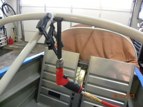

Drilling the cross member support
