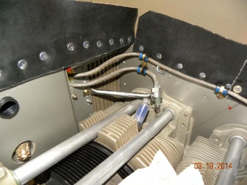

Brief Description:  Oil Cooler Brace
The engine baffles are prone to cracking from the weight of the oil cooler hanging off the back baffle. I stole this idea from what other have done and added a stainless steel kicker from the cylinder head fastener to the oil cooler. This diagonal brace completely firms up the intersection here so there is no movement whatsoever.
