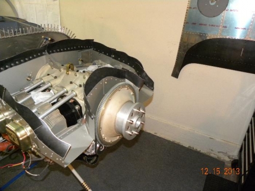

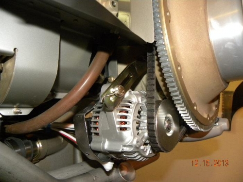

Brief Description:  Flywheel install
The flywheel has been off for quite some time while working on baffles and other firewall forward wiring. I reinstalled it and reset the alternator belt tension and fastened the alternator in place. I also safety wired the alternator tension bolt in place. The alternator has about three different locations requireing safety wire... the previous two are only accessible with the flywheel off.
