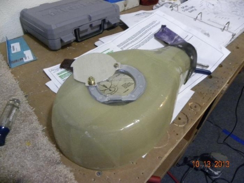

Brief Description:  Filtered Airbox
As a precautionary measure an alternate intake air source to the engine is fabricated into the filtered air box. This intake in the bottom of the airbox is on the carb side of the airfilter and can be opened from the cockpit via a push pull cable. In the event that the main intake gets clogged or iced over, this will draw direct air from inside the cowling up into the carb.
Inside of Alt Air Door
