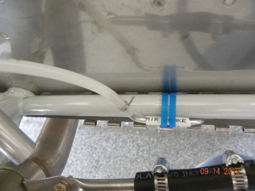

Brief Description:  Fuel Overflow

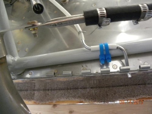

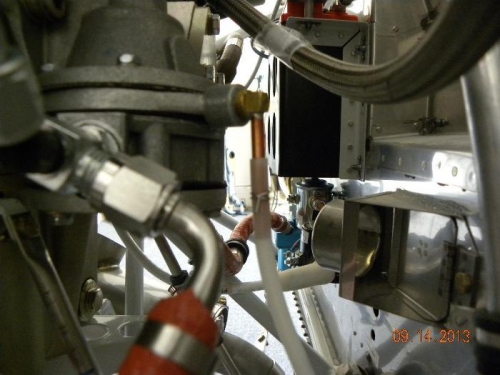

The engine driven fuel pump has a spigot out the back for an overflow drain line. The drain line supplied with the kit is a parker fluid line. It needs to be routed out the bottom of the cowl. I drilled a hole in the forward facing flange of the firewall and bent an aluminum tube around the engine bracket for securing it in place and to exiting through the hole. The plastic tubing gets safety wired to the copper spigot and aluminum exit tube.

Overflow Exits through bottom firewall flange
Safety wired to copper spigot exiting the fuel pump
High temp zip ties hold bottom aluminum tube in place
