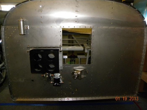

Number of Hours:  12.00
Brief Description:  Firewall Components

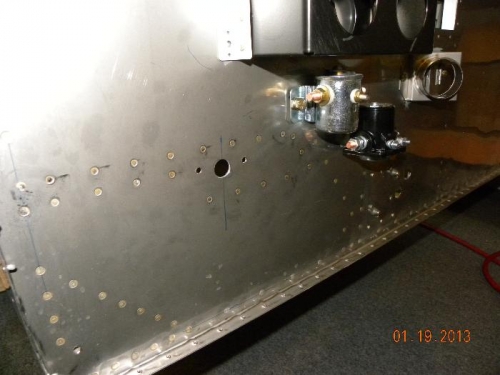

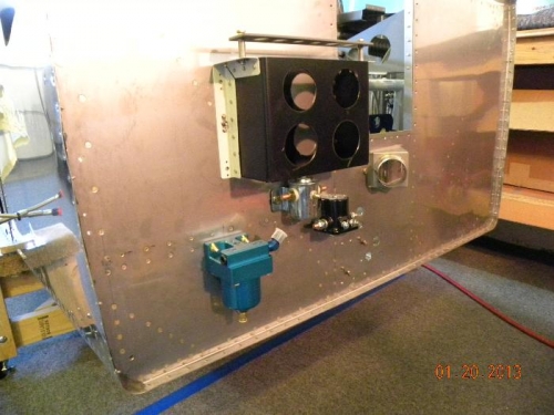

Over the past few days i have bee poking away at the firewall elements. I figure these are best done now while it is open to the sky. There is actually quite a bit of fabrication involved in terms of drilling holes in the stainless steel, mounting doubler plates, riveting and installing plate nuts. The battery box is pretty stock too.
So far i have fabbed and installed the battery box, cabin heat bybass, master relay, starter solenoid, gascolator and brake fluid resevoir.
