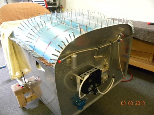

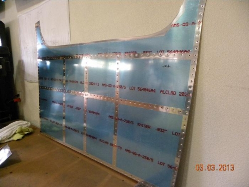

I deburred and dimpled the forward top skin, which is the last major skin in the entire project that needs to be dimpled and deburred. Afterwards I clecod it in place on the fuselage.
I also started installing some components on the firewall from the electrical kit and the firewall forward kit.
I installed the fuel and oil lines to the transducer manifold, with associated plate nuts and hose clamps.
I Installed the battery positive and negative wire terminals to the firewall as well as the engine case ground.
