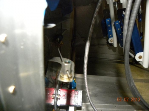

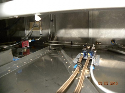

Installed swiveling "B" nuts at the ends of the parking brake and cabin heat push control rods. I used some loctite on the set screws to the cable. I left enough slack in the line that if I ever cannot back-out the set screw, i can just cut off the B nut and install another. The parking brake and cabin heat controls are now complete.
Parking brake control rod to far right, heat b-nut to far left
