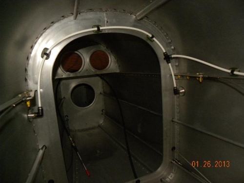

Brief Description:  Static Line
I installed the white static line tubing to the static ports in the rear fuselage. I adhered some Clickbond zip tie stanchions to the rear bulkhead and skins to secure the lines in place. While I was at it I dropped in about a half a dozen other stanchions on the floor of the rear fuse for future wire bundles to be fastened
Dual Static Ports
Dual Static Ports
Rear Fuselage Static Line routing
