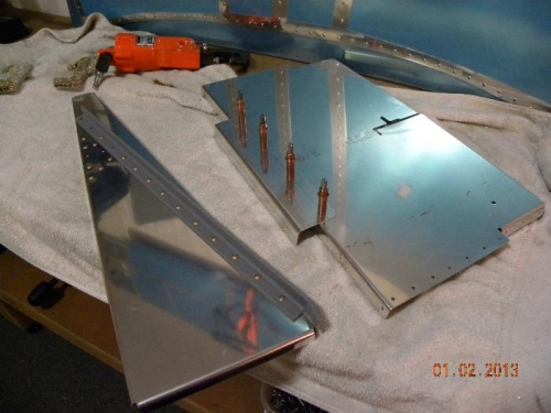

Brief Description:  Subpanel Structure
Fabricated and riveted the stiffener angle and backup plate to the center rib of the forward fusealge. I also fit the center rib into the slot of the subpanel, which requires twisting and contorting the subpanel quite extensively to make it work. This scratched the primer and aluminum all to heck, so needless to say these wont be coming apart again, i will prime them just how they are.
