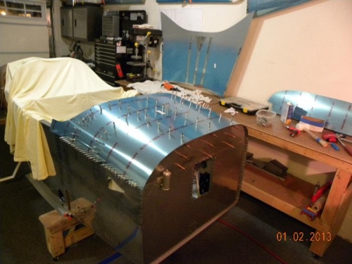

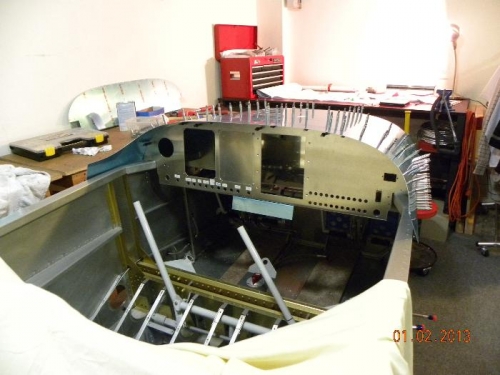

The ribs and panel that make up the forward fuselage come together quick, but there is a bunch of misc. tasks to complete before this all can be riveted in place. The strcuture consists of three ribs, and sub panel and a panel.
Stretching the skin over this was real difficult. I can see it will be real interesting trying to rivet this top skin in place once all the cavities are filled with avionics and wiring...
I can see already the subpanel will need a big slot cut in it for a couple of the avionics trays to pass through. For example; the space between the panel and the subpanel is about 9" but the length of the Garmin SL30 Nav/Com is about 12".
I match drilled these parts together and started working of the brackets that secure the bottom of the panel, and cockpit venting in place.
Forward Ribs, Subpanel and Panel
Forward Top Skin Cleco'd in Place
