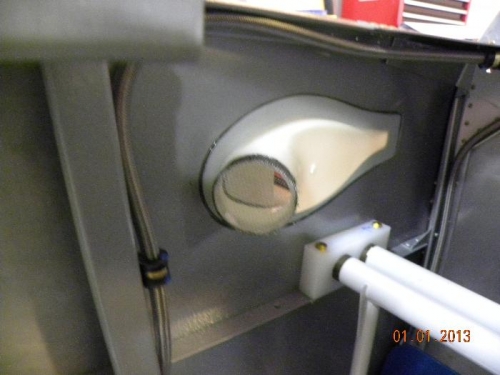

Brief Description:  Bug Screen over Fresh Air Inlets
There was no screen provided in the ductwork for the NACA vent fresh air inlets so I purchased some aluminum mesh screening to install in the vent to prevent bugs / insects from finding there way into the cockpit ventilation system. I cut and molded the screen around the plastic inlets and used pro-seal to adhere it in place. I used a rubber band to temporarily hold the screen to the sealant while it dried. Additionally, when the scat tube is installed; the hose clamp will clamp the screen in place
aluminum screen fitted and pro sealed in place.
