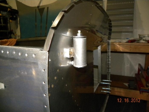

Brief Description:  Install Brake Master Cylinder
I located and drilled the holes for the brake master cylinder. I also fabricated a couple 1/8" shims to allow the cylinder to standoff the firewall a bit to clear the slope of the top of the firewall. Once the brake lines are secured to the fitting, I will firecaulk the penetration through the stainless steel firewall
