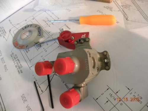

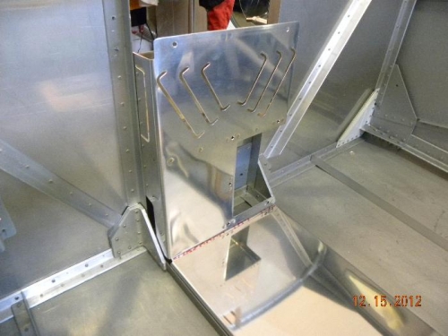

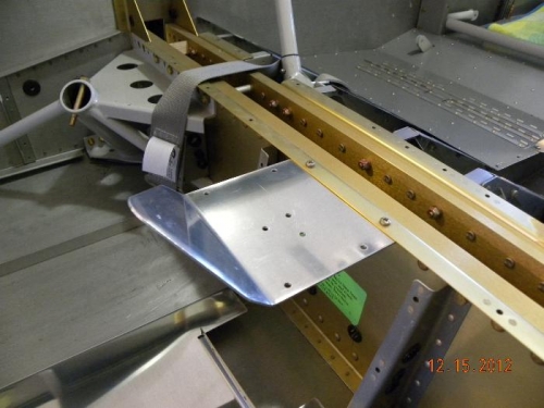

This day I finished the balance of the forward fuselage interior panels, which included the fuel selecot valve / trim cable housing, and the center tunnel / heat baffle. These parts were pretty well fabricated and only required final fit-up, match drilling, deburring, dimpling, nutplates, etc. These covers will hide all the brake and fuel / pump lines in the future, so once they're off for painting, i probably wont be putting these panels back on for awhile.
Fuel selector and elevator trim bezel
Cabin Heat baffle
Cabin Heat baffle
Andair fuel selector disassembled and nutplates riveted on fastener holes.
