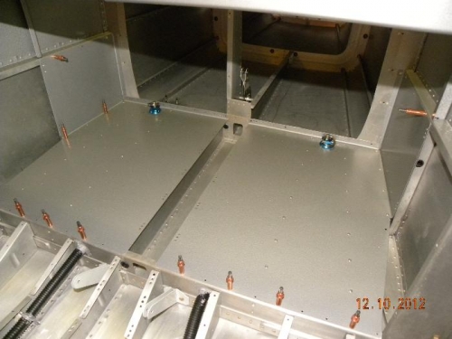

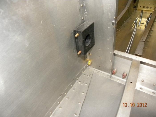

Riveted the baggage floors in place.
Verified torque on rear wingspar attach and seat belt restraints

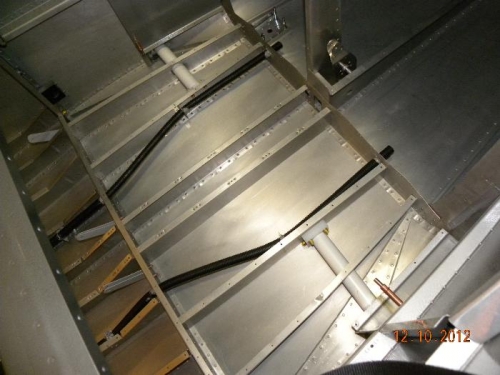

Cleaned area below baggage floor and document conduit routing
Closed her up - Riveted nut plates at perimeter and blind rivets (LP4-3's) in field
