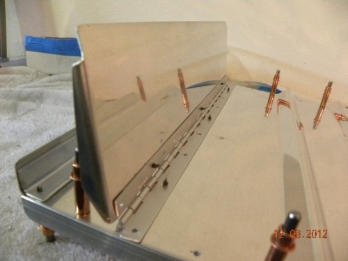

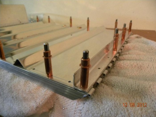

Number of Hours:  3.00
Brief Description:  Start Drilling Seat Backs
