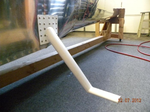

Well, i recently primed the two steel steps with some new white colored Stewart Systems primer i got from ACS. Finishing the step install has been holding me off from finishing the final riveting of the baggage floor and side panels. So, I decided to rivet the steps in place, even though now i'll be tripping over these suckers for the foreseeable future.
When i got the step kit i saw that it gave the builder an option of riveting the flange to the side of the fuselage using either blind rivets or AN470-4's. Deep down, for simplicity sake, i've always wanted to just use the blind rivets. However I never want to feel as though i was cutting corners, so i've been battling this back and forth for some time.
Well, today I went to the shop, started working and it just sort of happened - the steps got riveted in place with the pop rivets. First I lathered up the backside of the flange with some proseal and cleco'd it in place while I inserted the AN3 bolt on the UMHW block under the baggage floors.
My reasoning for the pop rivets is as follows: First off, there is one row of rivets that is blocked by a fuselage stiffener from any bucking bat that I own; so i would either need to buy or fabricate a bucking bar for these 5 rivets, or pop rivet them anyway. Second, I have horrible luck with -4 size an470 rivets. I would likely smuck the skin a few times in the process of riveting them. Third, no helper around to buck rivets. And last but not least - is someone really going to stair at the rivets on my steps? I dont think so. If it saves time, go for it. Now that its all said and done I actually like the look of the blind rivets anyway!
