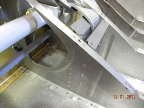

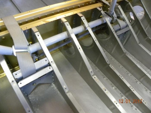

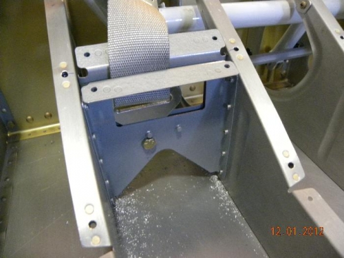

Brief Description:  Install Crotch Strap Kit
Installed optional pilot/co-pilot crotch strap kit to go along with my Crow 5 point harness. These brackets are drilled to the seat ribs and pop riveted in place. The strap is sandwiched between the two plates and bolted in place. I used three 6mm washers as bushings to make a tight fit of the bolt through the harness hole. I primed the brackets and hit the tops with silver hammered where they will be visisble. These were simple, but very time consuming becaue access is tight, they need to be taken in and out several times during the install.
