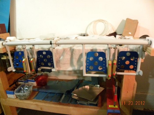

Brief Description:  Brake / Rudder Assembly Assembly

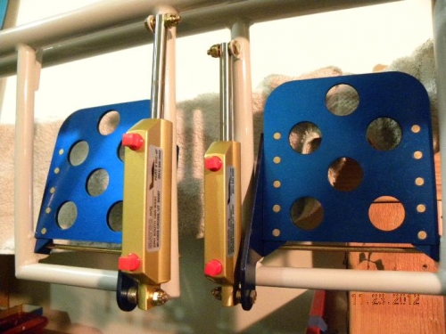

Finished building up the rudder pedal / brake assembly including drilling the master cylinders to the brake pedals. I added the JD-Air black anodized bolt on pedal extensions to the pilot side and kicked the angle of the break pedal slightly forward to help keep the toes off the brake pedals while landing. If this works out I'll add a second pair of extentions to the passenger side. I plan to do the common mod of adding a return spring over the cylinders, to aid in bringin the pedals all the way back to neutral.... apparently these matco cylinders can get sticky. ( parts on order from mcmaster.)
