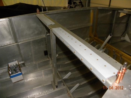

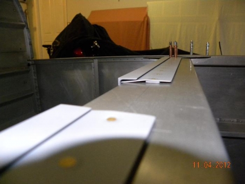

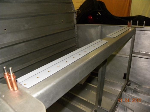

Brief Description:  Fab/Install Seat Back upright Supports
The 705 bulkhead (just behind the seats) is mostly put together and temporarily blind riveted in place. One major portion left off is the F705-J,K,L pieces that support the seat back upright (two available postitions.) THese are mostly fabricated from angle and sheet, and are not pre-drilled. I fabricated and primed the pieces and riveted in place.
I also finished off all the rivets supporting the F-705 bulkhead that were left out for optional components of the tip-up canopy version. (im going with slider)
