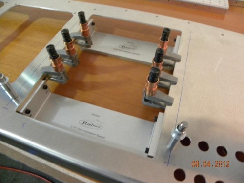

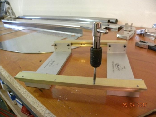

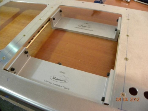

The install was pretty simple. A spacer is provided to set proper distance between the rails of 6.30" then the holes are drilled through the panel and rails. I opted for counter sunk screw hardware in lieu of riveting, so they are easily removable. I tapped the holes in the rails to accept a 6-32 screw.
Radiorax offers several shapes and sizes, primarily for non-experimental aircraft. The kit i bought is there least expensive 8" rail kit geared towards the RV type. Because the rails were about 3/4" short of spanning the entire height of my stack opening i had to do some careful planning as to the position, so i wouldn't miss the rail with the tray fasteners at top and bottom.
Rails cleco'd in place for drilling
tapping the screw holes (6-32)
Countersunk fasteners in place
