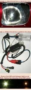

For a landing / taxi light I plan to install 50W HID's into the leading edge cuffs of the wings. (preferably both wings if budget allows) I have flown a plane before that had a four bulb LED as a landing light and i would have been better off wearing a headlamp. Im sure there are LED landing lights out there that are more than sufficient, for the right price... but in my price range im going with HID's for landing/taxi and LED for strobe/nav. I've seen planes flying around with LED strobes at night and they look pretty cool, not to mention last forever and suck barely any juice.

50W HID Landing / Taxi
