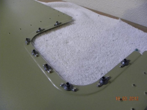

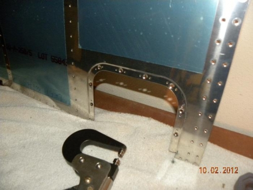

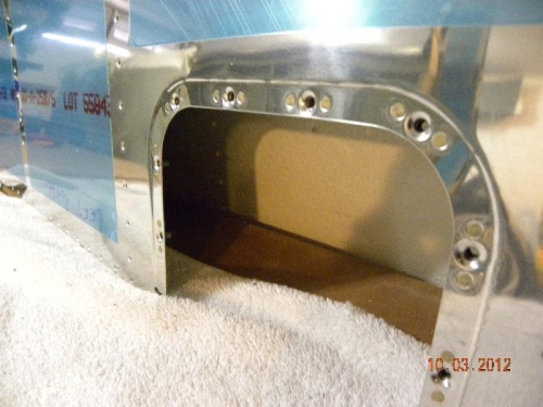

Brief Description:  Install Access Cover Nut Plates
The bottom of each wing has three access holes with removable cover plates. The cover plates are held in place with countersunk screws. I drilled, deburred and dimpled all the rivet and screw holes and then riveted the nut plates to the bottom wing skins.
