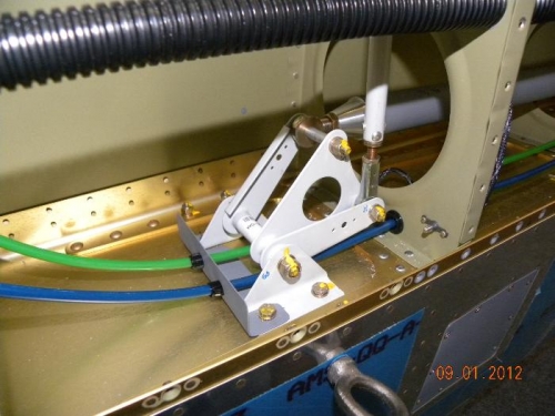

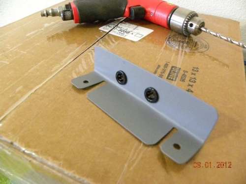

Brief Description:  Bellcrank Pitot Bracket
I fabricated a bracket from some scrap aluminum sheet. This bracket is secured to the bellcrank and installed two snap bushings in the bracket to feed the Pitot and AOA plumbing lines through. This will secure the lines from interfering with the bellcrank as they pass by.
A second similar bracket will be fabricated to secure the lines at their ends where the plug into the AN fittings at the pitot tube.
