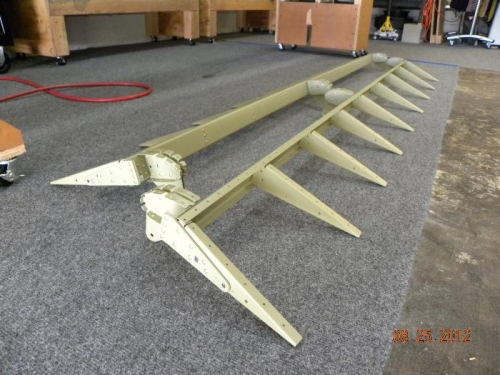

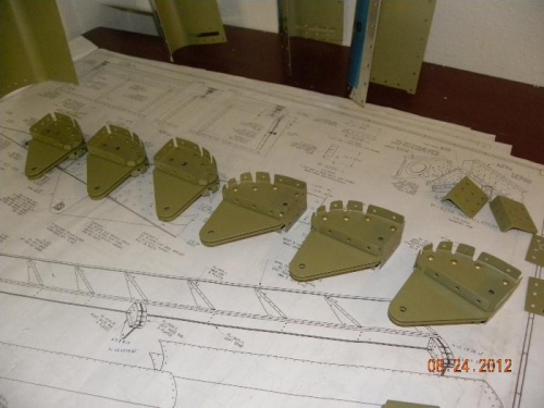

This morning i finished priming the skins and leading edges and went right into assembly. I finished priming all the skeleton parts last night so these were ready for riveting. I riveted the hinge bracket assemblies at mounted them and the ribs to the flaps maing spar. This created the skeleton for the flaps. Most rivets were accessible with the pneumatic riveter which was nice.

flap hinge bracket assemblies riveted together
Flap Skeletons Riveted
