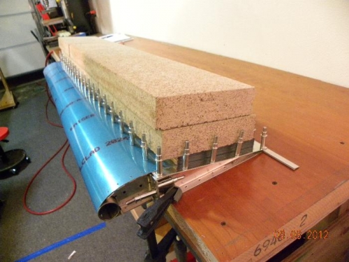

Aileron construction was straight forward following the instructions. Weighting the ailerons down is extremely crucial during drilling and riveting of the trailing edge. without weights the trailing edge looks like a snake. I used some 2" x 8" x 16" concrete patio pavers over plywood to evenly distribute the weight and flatten the aileron for drilling and riveting. I planned to used lead shot bags, but could not find any in this concrete jungle. The pavers were only about $.75 cents a piece at the home depot aero supply.

I finished off but setting double flush rivets in the trailing edge. i DID NOT use pro seal on the trailing edge as I did during the rudder and elevators. It was not necessary and the ailerons turned out perfect.
A lot of people end up scrapping these and starting over... i got er the first time. On to the flaps; which are real similar in construction but twice as big.
Concrete weights for drilling trailing edge

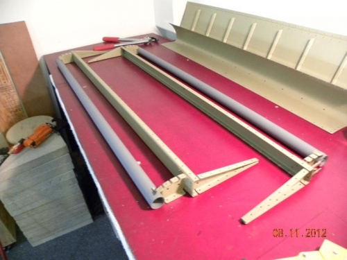

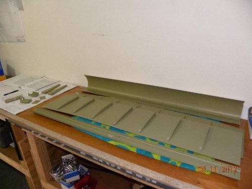

All parts primed
All parts primed
Aileron Skeletons assembled and riveted.
