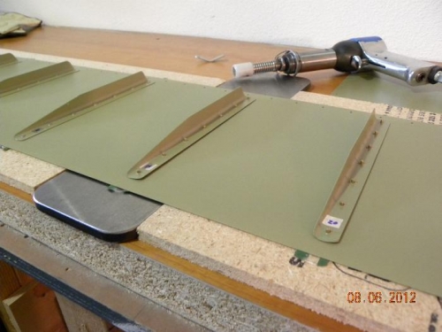

Earlier I had prepped the aileron skins by placing the rivets in each hole and securing in place with rivet tape. On the way home from work i stopped by the home depot aviation supply for some 3/8 underlayment board to place on the adjacent sides of my back riveting plate. This will keep the skins flat / flush with the back plate as best as possible.
Next I took to the back riveting and whipped out all 196 rivets in probably less than 20 minutes. I love back riveting; so simple and produces superb results all the time. I wish the whole plane was back riveted. Anyway, after alot of cutting, drilling, deburring, etc. the aileron skin with back stiffeners are complete.
Back Riveting over Plate

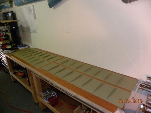

Primed Insides with Stiffeners Riveted in Place

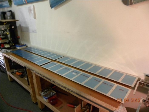

Exterior of Aileron Skins with Perfectly Back-set Flush Rivets
