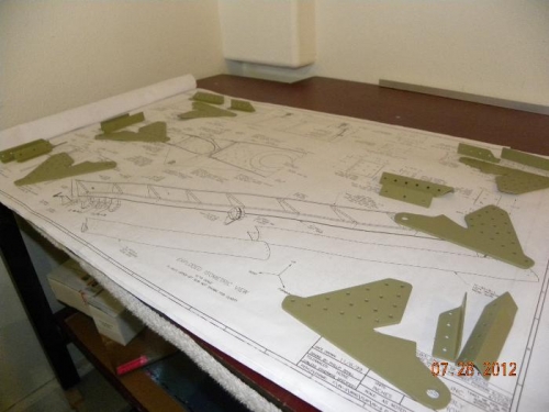

These brackets are thick aluminum stamped from a press that require a ton of duburring at the edges to remove the cut marks. There are also several small angles that needed to be fabricated from stock angle. The plans are very lacking in this department. Much time was spent pondering the drawings and searching other builders sites.

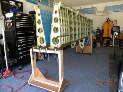

Since most work now is towards the trailing edge of the wings, i fabricated a new type of cradle stand to hold the wings with the trailing edge up, as opposed to down, on my my wing jig. I installed casters on the bottom of each cradle for ease of relocation. This is likely how the wing will be stored, when i move on to the fuse.

Flap Bracket Parts
Flap Bracket Parts

Wing happily resting in it's new cradle
