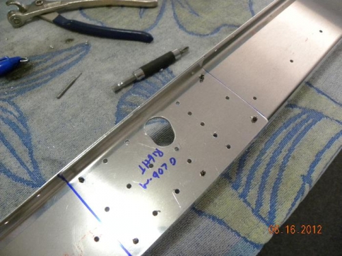

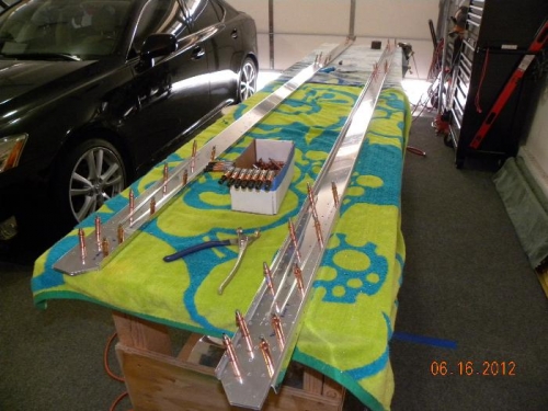

Pulled all parts for the rear wing spars, removed the blue plastic and deburred all the edges. I fit the spar doubler and reinforcing plates to the rear spars and match drilled all components. The aileron push rod hole is oblong and needs to be matched through the corresponding reinforcing plate. I used a step drill at first and finished off the opening with a dremel and small reamer bit. The carefully deburred all these edges. I disassembled and deburred all holes.

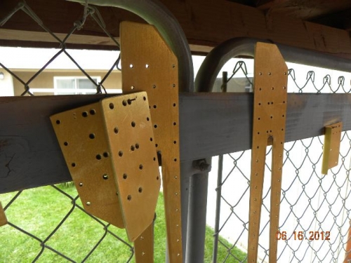

Disassembled everything, acetoned, alumaprepped, alodined and primed. These are curing in the garage for now, ready to rivet tomorrow.
Reamed/match drilled push rod openings.
Rear wing spars Cleco'd and match drilled
Alodined parts ready for primer
