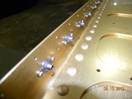

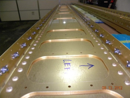

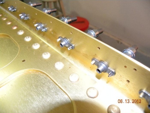

Rivet Tank Attach Plate Nuts
Riveted the K1100-8 dimpled plate nuts to the countersunk and primed holes in the top and bottom of both front spars. These plate nuts will be used to fasten the leading edge fuel tanks to the main spar.
