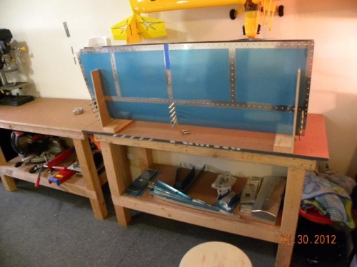

INtermediate Main Ribs to Front Spar

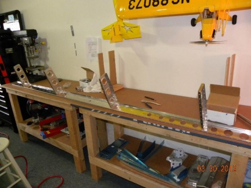

Nose Ribs Cleco'd in Place

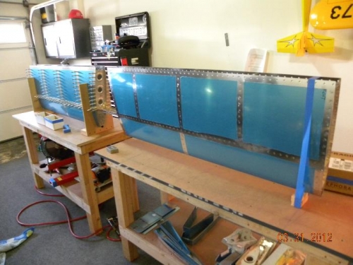

One Half Complete
One Half Complete
