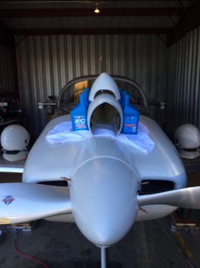

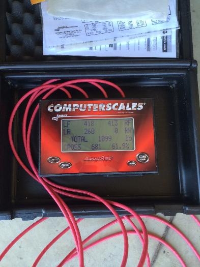

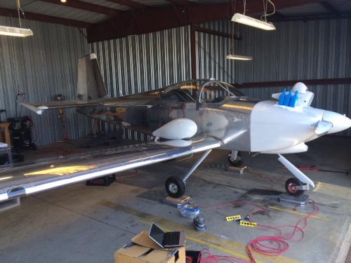

Performed the weight & balance of the finished aircraft. Thanks to the help of Bill Cary and the use of his nice racecar scales and pre-built RV-9A W&B spreadsheet. I ran various scenarios of W&B and CG and found all limits within range to certify the plane to 1800 lbs.
Later I actuall moved the fairings to the wheels for final measurement
Not too bad for full interior and fairings
