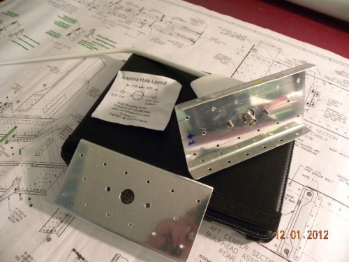

Brief Description:  Fab Comm Antenna Doubler Plates
I ordered an extra f-697 vertical cover plate and used the profice to slice and dice some doubler plates for the dual comm antennas. I will be placing two comm antennas on the belly. The doubler plates are on the inside of the belly skin in the outside bays of the seat ribs. They will be riveted to the bottom skin and adjacent rib.
comm antenna doubler plates
