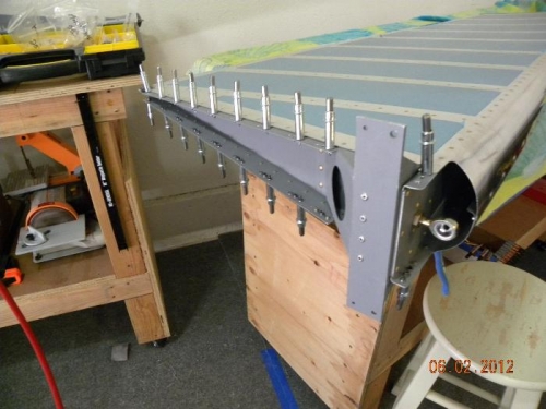

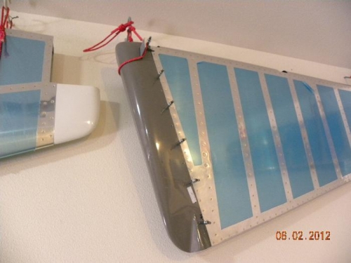

Fit fiberglass rudder bottom to bottom of rubber by endless trimming of the fiberglass. Used a cutoff wheel on a dremel tool for this and it worked well. The cut lines shown on my piece of fiberglass were pretty close.
In installed K1000-6 nut plates to rudder to enable the fiberglass piece to be removable in order to plumb nad service the wires to the Aeroled Suntail strobe light.
Nutplates drilled and cleco'd in place
Nut Plates riveted with an426ad3-3.5's
ready for washers and fasteners.
