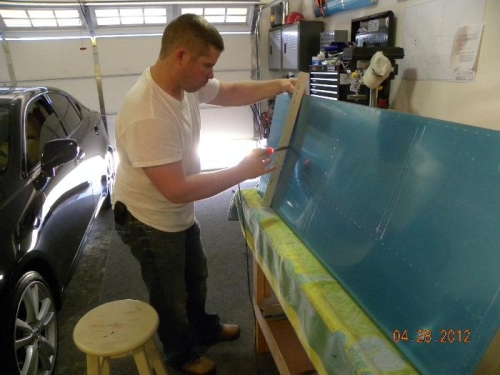

Primed parts, riveting Right Skin to Skeleton
Me removing protective coating along rivet holes

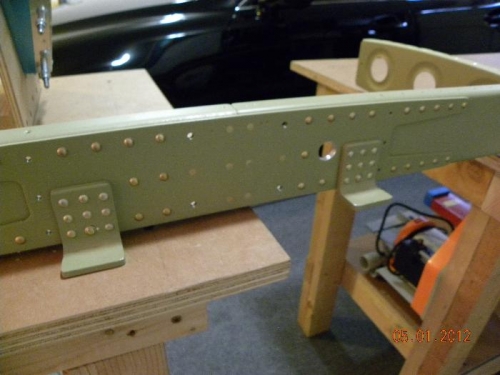

Front Spar and Attach Angles.
