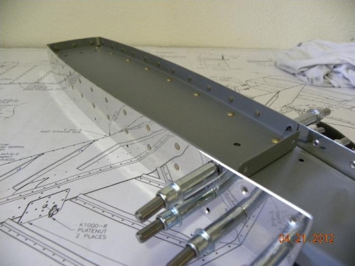

Next i fit up the skeleton for the right elevator including the forward spar, root rib, tip rib, reinforcement plates, and control horn - installed this into the skins for match drilling. On the bottom of the elevator surface where the skin rivets to the spar i am using a combination of flush rivets (where accessible) drilled to #40 and blind rivets where not accessible drilled to #30. this is per the manual, only difference is i could use blind rivets all the way across the bottom of the spar. Disassemble, debur, dimple, etc. got to use the table again to work the C frame dimpler up into the leading edge to dimple the skin.

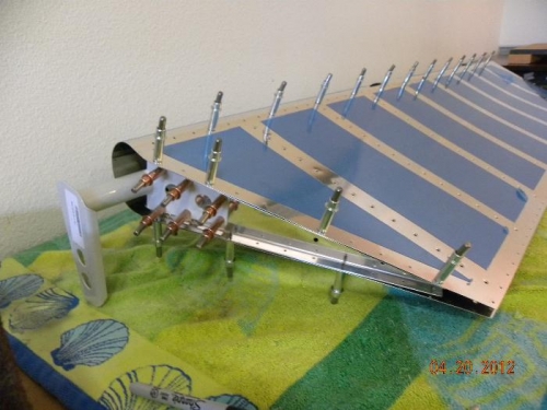

Riveted the hinge plates, nut plates, root rib, control horn to the spar forming the skeleton. Got some help from my wife to spread the skins apart while I back riveted all the stiffeners (16) to both skins. She also helped put those tiny rivets into all the holes and then we taped the

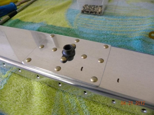

Hinge Reinforcement and Nut Plate
