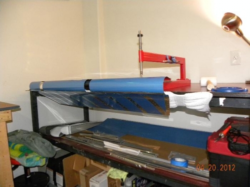

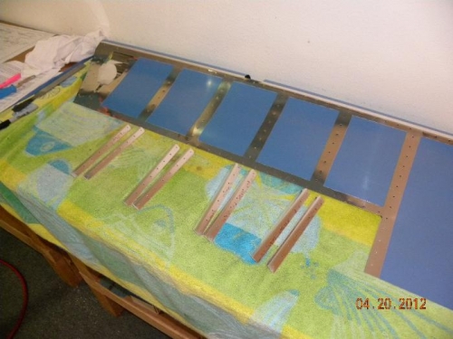

Fit all the stiffeners to the left elevator, trimmed the appropirate stiffeners around the notch for the trim tab. Match drilled and deburred the Left Elevator. Finished dimpling all the stiffener ribs with the pneumatic dimpler. Dimpled all stiffener holes in both the left and right skins on the C frame dimpler. I reversed the male/female dimples from normal and had to guide the male dimple through the top of the skin for each hole, this allowed me slide the tight skin over the edge of the table. (I protected the edge and underside of the table with a towel - I also put some scotch tape over the female dimple which alowed me to slide the skin across it without scratching the skin.)

Dimpling Right Elevator Skin.
Stiffeners Cut to Length around Trim Tab Opening (Left Elevator)
