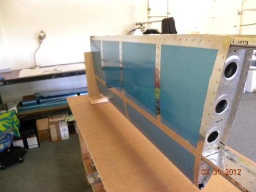

AN426 Flush Rivets on Surface

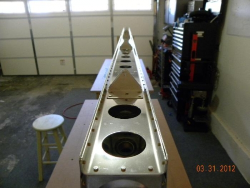

Nice Quality Hand Squeezed Rivets

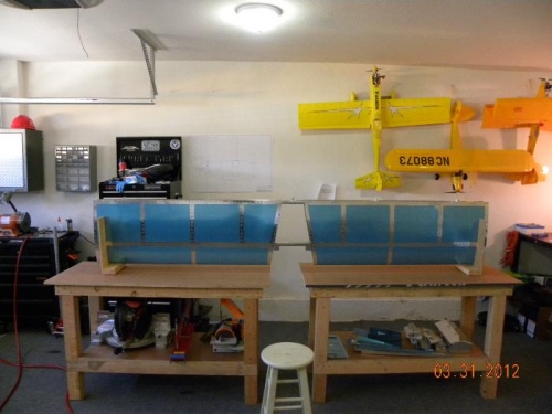

Complete Horizontal Stablizer
