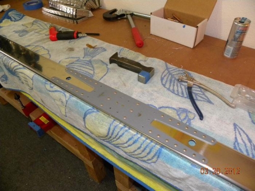

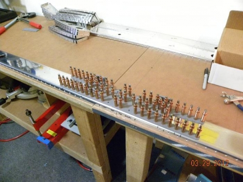

Started the day by clecoing the front and rear spar halves together using the doubler plates. By very carefully following along on the plans for rivet size and type I started riveting the pieces together. After both spars were assembled i riveted on the hing brackets to the aft side of the rear spar.
I drilled out and replaced about four rivets that i did not like; did a few more later in the day on the ribs. The first few i drilled out did not go too smooth but now i am comfortable drilling out any rivet. Once you get comfortable with it it's no big deal, you also dont try and talk yourself into leaving a bad one. Just have my airdrill and punch nearby - piece of cake.
Front Spar Cleco's
Front Spar Cleco's
Front Spar Riveted
Front Spar Riveted
