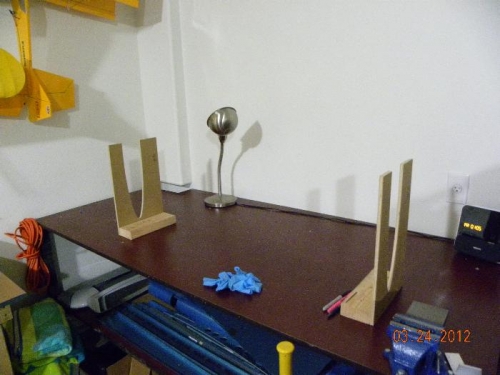

Brief Description:  Cradle Jig
Built the cradle jigs for the horizontal stabalizer skins. I used my band saw to cut the templates from Vans. Then i clamped the two together and sanded to a smooth finish, the two profiles match well this way. I set the spacing per the manual and screwed these to my table that i have already set plumb and level.
Jig Fastened to Table
