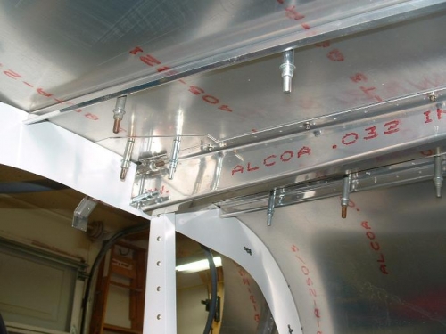

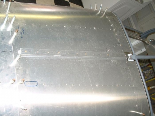

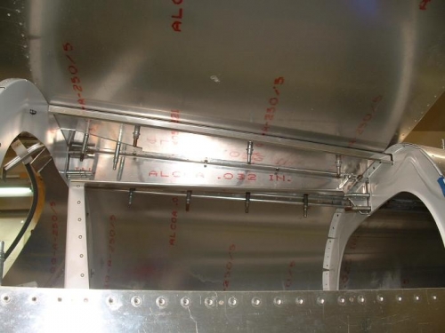

Brief Description:  Canopy frame slide, stiffening channel, skin gusse
I spent most of the day drilling up the frame slide and associated parts. I un-cleco'd the left side of the fwd/upper skin to gain access which made it a lot easier. I will be installing nutplates on the lower side of the upper flange of the F-682 stiffening channel. I don't anticipate needing to remove the frame slide very often but it will sure be handy if I ever do.
C-762 Frame Slide
C-762 Frame Slide
Skin Gusset, F-682 Channel
