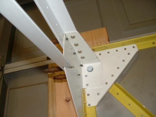

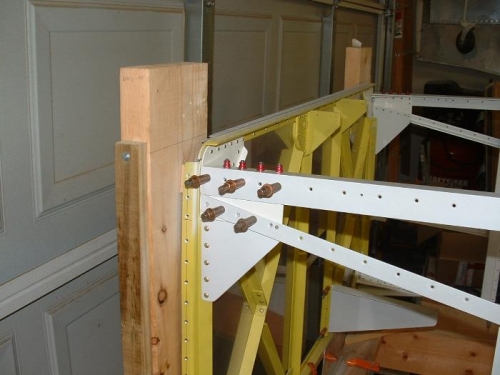

Brief Description:  Fwd Fuselage Structure

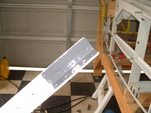

Today I permanantly attached the lower fuselage angle structure to the firewall. I used close tolerance hi-loks instead of the AN3 bolts that the drawing calls for. I had them laying around from my days with Delta Airlines. Sice this is a pretty critical spot I think the hi-loks will be stronger. I applied sealant on the faying surfaces since they are dissimular metals.
