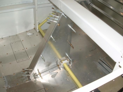

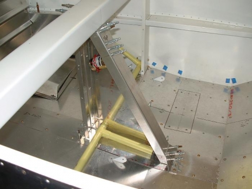

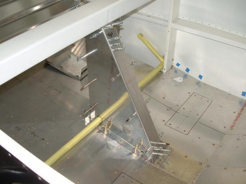

Date:  12-17-2011
Number of Hours:  12.00
Brief Description:  Flap Actuator Enclosure
I have spent the last couple of days installing the flap handle and the flap actuator enclosure. I will need to modify the handle because it is the manual type and the ends need to be cut (shortened) and have new brackets welded on for use with the electric actuator motor. I temporarilly installed the handle and built up the parts that make up the actuator enclosure. I then removed everyting and drilled all holes to final size and set it aside for painting later.
