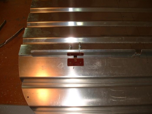

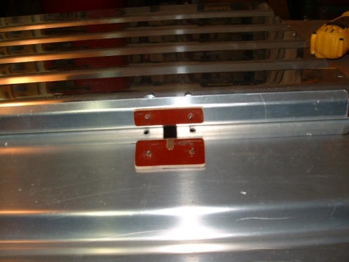

Brief Description:  F656L and Shoulder harness cutouts
Today I fabricated and drilled the F656 gussets on the left side. I also made the cutouts in the F652 baggage panels for the shoulder harness cables to pass thru. I couldnt find the UHMW material that the plans call for installing to keep the cables from chafing the panels so I used some 1/8" thick phenolic that I had laying around. It will serve the same purpose and is probably a little lighter.
