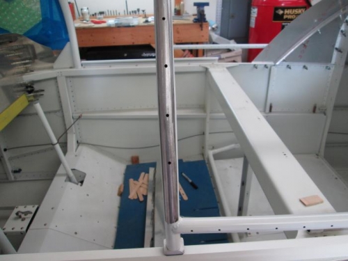

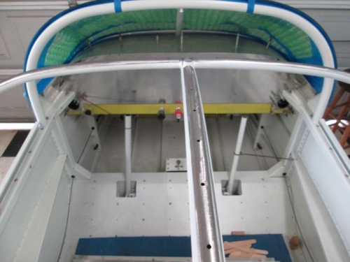

Brief Description:  Prep for bonding the canopy
Today I prepped the canopy and frame to be bonded. I plan to use 3M 5200 adhesive to bond the two together. I called Todd from "Todds Canopies" in Florida and talked to him about what prep work was required for this adhesive since I have never worked with it. He told me to rough up the plexi-glass with 80 grit sand paper and drill holes in the frame every 2-3 inches. I did this and wiped both parts down with acetone. I placed the plexi on the frame and positioned tongue depressor sticks around the bows to get the right height and to allow a gap between the frame and plexi to apply the adhesive.
