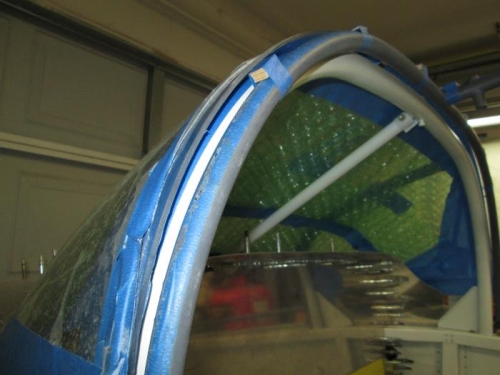

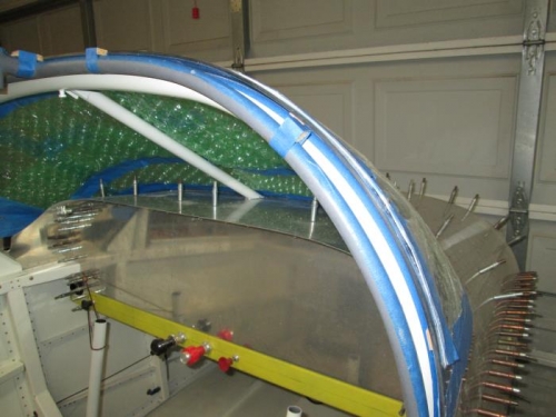

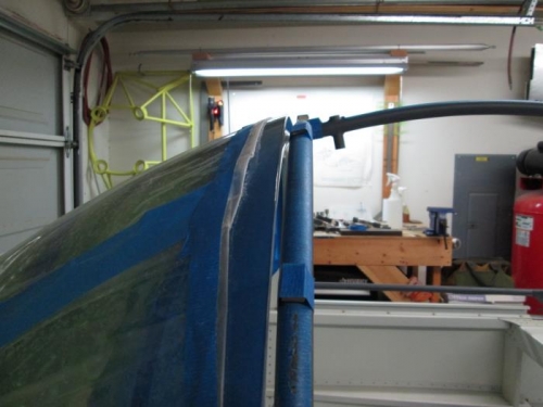

Brief Description:  Sliding canopy
Now that the windscreen is final trimmed and in place, I put the sliding canopy in place to check the fit. And the fit is terrible! The forward bow of the sliding canopy frame doesn't match the roll bar at all. As the pictures show, I had to shim the canopy off of the frame to get it to match the windscreen. Over 1/2" in places. I have no other option but to cut the forward bow off of the frame and try to re-bend it to match the roll bar.
