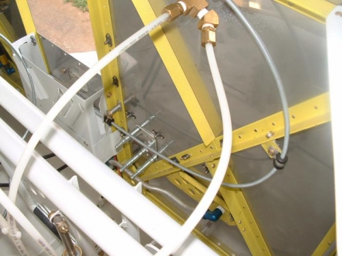

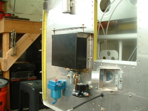

This weekend I continued working on modifying the battery box installation. I replaced the angles for mounting the bat box with some that I fabed out of .032" stainless. Since my battery box has a hinge installed on the bottom to allow it to rotate forward to for clearance from the brake reservoir, I wanted to install the attaching hardware for the angles front to rear. The angles included in the kit from Vans had the pre-drilled holes for installing the nutplates on the angles. I could have used them but there would have been a lot of empty holes. I also temporarilly installed the master and starter relays. I fabed up the firewall doubler and need to prime and install it before I can mount the relays permanently. I ran the wire for the elevator trim servo thru the bulkheads but I'm still waiting on parts to complete the install. Maybe next week.
Battery box install complete
firewall doubler for relays
