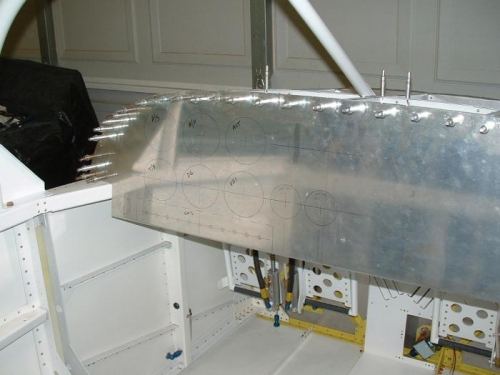

Brief Description:  Brakes, Fuel vent line, Instrument panel
I decided to move the brake res to the right side after the plumming nightmare I endured last week. I'll need to blank out the holes in the previous location or just use them for something else. After that I permanantly attached the fuel vent lines with hardware and epoxied the screens to the AN fittings that vent overboard. I spent a little time laying out the basic flight instruments on the panel. I'm sure this will change multiple times beforel I decide on what exactly is going in there. I plan to set it up for just a basic day/night vfr panel.

Started panel lay out for basic VFR.
