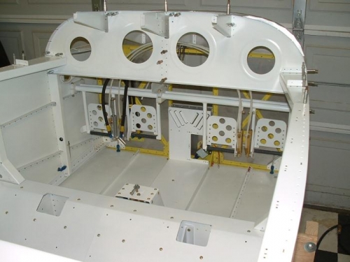

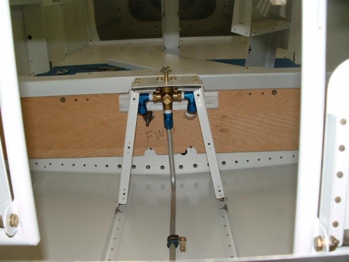

I assembled the center tunnel cover today and started to fab the fuel supply lines from the wings. I decided to wait till the wings are installed so I can route them along the spar. I plan to adel clamp them to a couple of bolts common to the spar. I want to make sure they are out of the way so I don't kick or step on them once the plane is built and flying. I then cleco'd the fwd fuselage structure in place so I could route the brake lines.
Fuel selector valve
Fuel selector valve
Fuel selector valve 2
Brake lines routed
Brake lines routed
